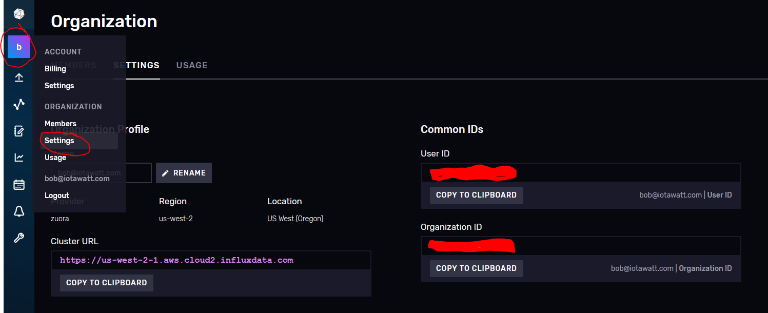

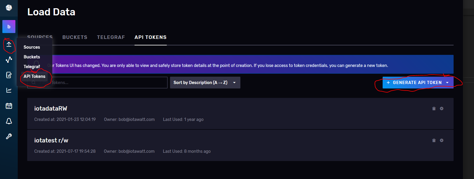

I can’t seem to update the uploader because it is requiring a 16 character organization name and a 88 character auth token but I don’t have those lengths programmed. Am I missing something? Very new to this…
Thanks!
Neil
Thanks!
Neil
They have moved some things around since the IoTaWatt Docs. Better to reference their Docs:
https://docs.influxdata.com/influxdb/cloud/organizations/
and
https://docs.influxdata.com/influxdb/cloud/security/

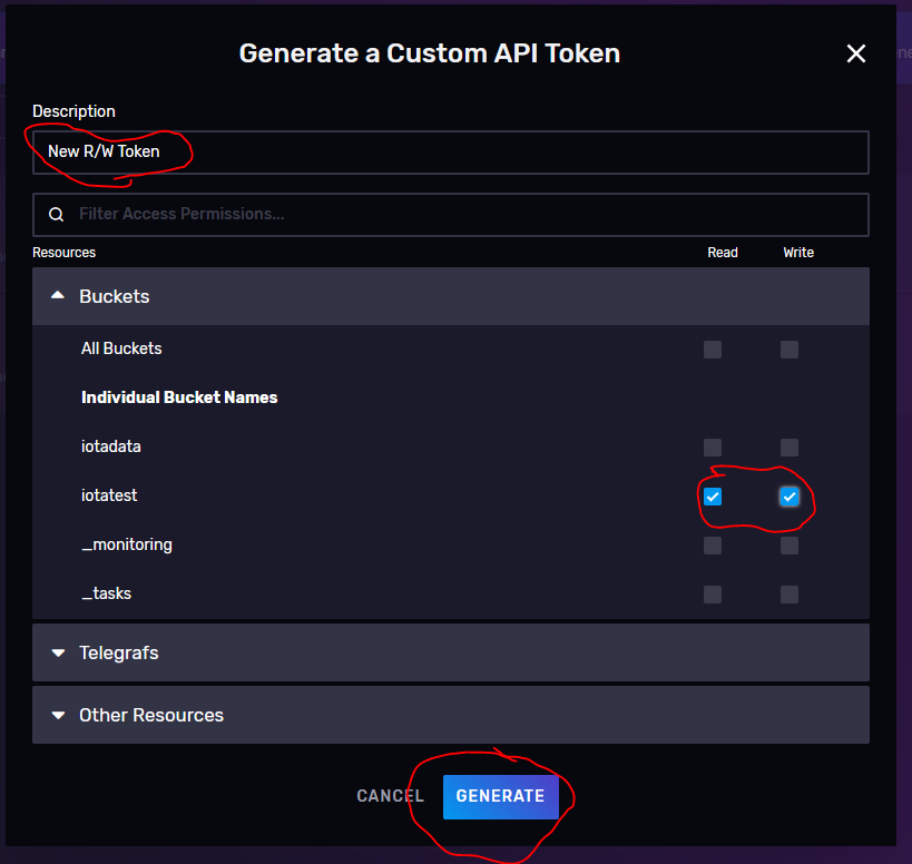

The auth token policies have changed. Now you can generate an auth token, but you must copy and save it at creation time as it cannot be displayed later. So you will need to create one, copy and save it, then also paste it into the uploaded setup.
