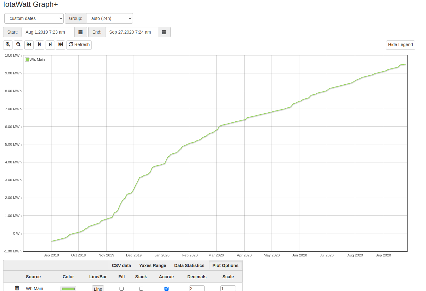

I have an Iotawatt that is at a remote location monitoring usage. I use it to calculate a meter reading to submit to the utility company every month as there’s rarely anyone there so no way to physically get a reading. Sometime in the last month the device started rebooting constantly. I just realized it tonight when trying to get this months reading. It also started re-uploading data to my emonCMS instance due to whatever corruption occurred as last month emon read ~9000kWh, and it’s currently reading over 22,000kWh which there’s no way that’s accurate. The 9000kWh is all that’s been used in the 13 months the Iota has been in place.
Is there anyway I can restore this without having to drive an hour and a half to the site? I suspect corruption occurred during a power outage a couple weeks ago. I don’t have the Iota connected to a battery backup as I read something that said it could be a hazard if the Iota was powered and there was no flow through the CTs? Is there a risk if I connect the Iota to a battery backup if there’s an hours long power outage? The site frequently has power flickers (it’s in the middle of the woods) and sometimes has outages that last 4+ hours. There isn’t much connected to the battery backup and it could easily last 2-3 hours during an extended outage.
