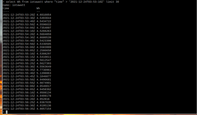

I’m at a complete loss to understand what has happened here. Some of my quandaries:
This isn’t just a switch to 5 second entries. The first such entry at 3:55:05 appears to have a 5 second value, but the subsequent 5 second entries have 10 second values. SO, I think there may be two different things happening here. The switch to uploading on 5, 15, 25, etc. with the correct value for the respective 10 second interval that overlays a separate previous (or later?) upload of true 10 second entries on even 10 second intervals.
When I look at the message log for that period I see that you were on the older MAJOR release 02_06_06 which predates the uploader rewrite that appears in 02_07_05. There was a WiFi disconnect on 12/07/21 00:20:42 (remember that) followed by a connect then another disconnect/connect. The log is then uneventful until 10 days later on 12/12/21 when a routine six-week restart happens. The influx uploader is started, but apparently cannot query influx for the ending time. It sits that way for 8 days until 12/25/21 when it seems to retry successfully and obtains a starting time of 12/07/21 00:19:40 - about a minute before that disconnect back on 12/07.
Now it gets interesting. The uploader is stopped 9 days later on 01/03/22 and the upload is current. A minute and a half later it is restarted and the upload date is 1/3/21 19:24:30. That would probably be the start date of your current log as it holds about 1 year. So either the database was wiped, or the measurements were changed and there were no matching previous measurements in the database. There are a few stops and restarts ending with a stop on 1/3/22 at 19:41 indicating the last post was 1/3/21 at 20:03:30.
Coincidentally, release 02_07_05 was made the MINOR release an hour later and it was installed. Upon restart, influx shows as stopped with entry on 1/3/21 at 20:45:20 as would be expected.
The next day (actually later that day after midnight, influx was started and it picked up from 1/3/22 at 19:22:10 - a year later.27 days later on 1/31/22 it was stopped, was current and then chugged until Valentines day when there was another six-week routine restart where influx started normally and up to date.

So that’s one story where part of it seems to missing like why the upload reverted back a year and then came back to reality. Was it that the database was changed or cleaned, or the upload measurements were changed (that would include changing tags) so that the existing data did not match the new uploads?
Regardless, there doesn’t appear to be any 5 second resolution data being uploaded at that time, or any other time. I’m at a loss to understand how this is happening. In your last post you had stopped the upload with a time of 12/29/22 23:03:05, then restarted at 12/29/22 at 23:03:10. Does it progress to 20, 30 etc or is it 15, 25 etc? When you look at the upload status display, is the time advancing as 15, 25… or 10, 20…?
I just did a query on the database for the last 10 records and they are showing 0 10 20 30 40 50. I just stopped and started the uploader to make sure the log was working. The only other thing I can think of that happened during this period (besides the other post I referenced above) was I had fiber installed at the house on Jul 28 2022. They put in a new router that screwed up a few IP addresses which I was able to fix, so I didn’t really think anything of it. As far as the status display, the last update on the uploaders is only changing every min and ends with :10. The Current data log time is changing every 5 sec.

I still question why the data seemed to be ok last month when I recorded the usage and it agreed with the electric company. However, when I noticed this month’s data was off and went back to last month, it was off as well. It would seem to me that whatever happened occurred sometime between (about) 17 Nov 2022, which is when last month’s bill was mailed and 24 Dec 2022 which is when I received this month’s bill and found the problem.
I’m convinced the basic problem is that the database was uploaded to twice. Once with time stamps that end in 0 and once with time stamps ending with 5. I have no idea how that happens, never saw it before with interval 10, yet your unit was doing it as recently as a few days ago.
