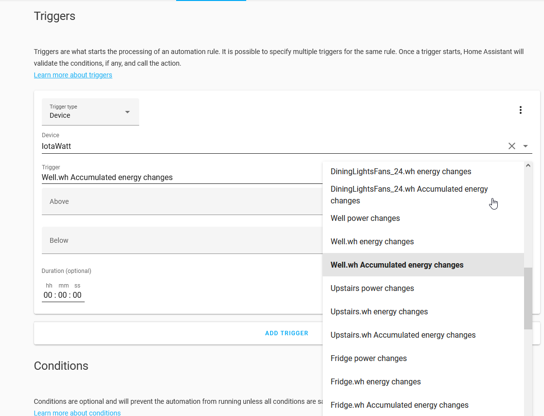

Thank you! I’ve installed Home Assistant and am playing around with it. You don’t happen to have an integration guide specifically for IotaWatt, do you?
For just integrating the IoTaWatt, their online guide is OK. If you have PV and want to track energy import/export through the home assistant Energy Component, there are some additional considerations in the IoTaWatt Docs here.
I am trying to configure alerts based on accumulated energy usage over a custom period of time. For example, if my well exceeds 36 Wh in a 30-minute timeframe. Measuring point-in-time values would not be sufficient. Do you know how I might define the timeframe used for the accumulated energy source?
No experience with HASS alerts. You might want to try asking the question on the HASS forum.
