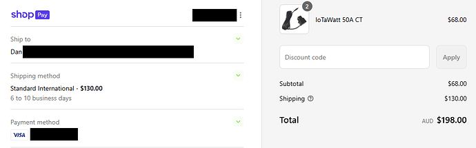

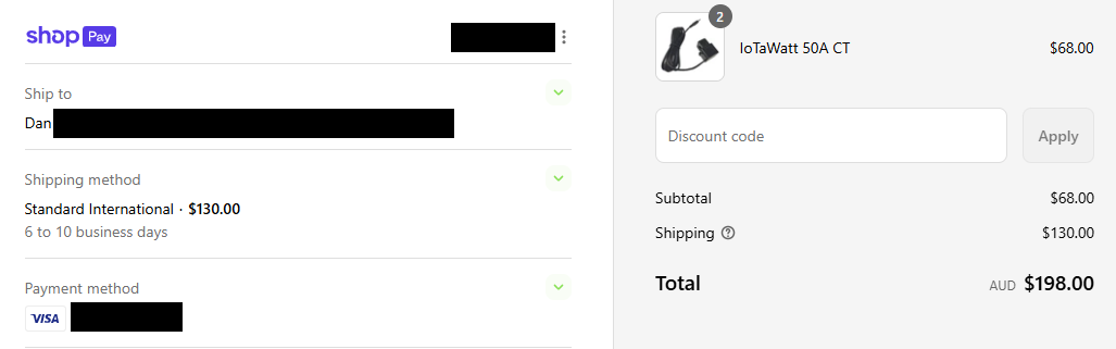

Any idea where I might be able to get a set in Australia? CircuitIQ will ship to Australia, but - as you can see - the shipping costs are an absolute joke…
