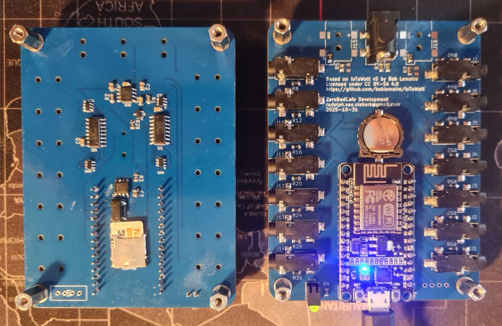

Status Update: First prototype PCB completely built up and working up to the point of Wifi connectivity (constant dull green LED).
Just waiting for my 100A Current Clamp CT’s and 9v AC adapter to arrive before I can install and fully test.
The built up PCB Assembly will be ~AUD90/unit.
I reckon people can order the CT clamps and 9Vac adaptor themselves.All in all you should be able to have a 12-sensor system installed for ~ AUD 250.
Fun fact (for those not-so-keen-eyed): I placed the SD card holder the wrong way around, :roll_eyes: :man_facepalming: … could resolve this by inserting the SD card before soldering the RTC crystal… effectively locking the SD in place. Obviously not a workable final solution, but I will rectify this in the next batch of PCB’s.

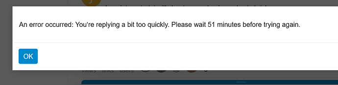

I cant DM you as for some reason there is a 1 hour cool down timer between posts. @overeasy whats with that? i reply to a post, and then go to send a DM and am met with the below. it happened a few weeks ago too, but i thought it was a glitch.

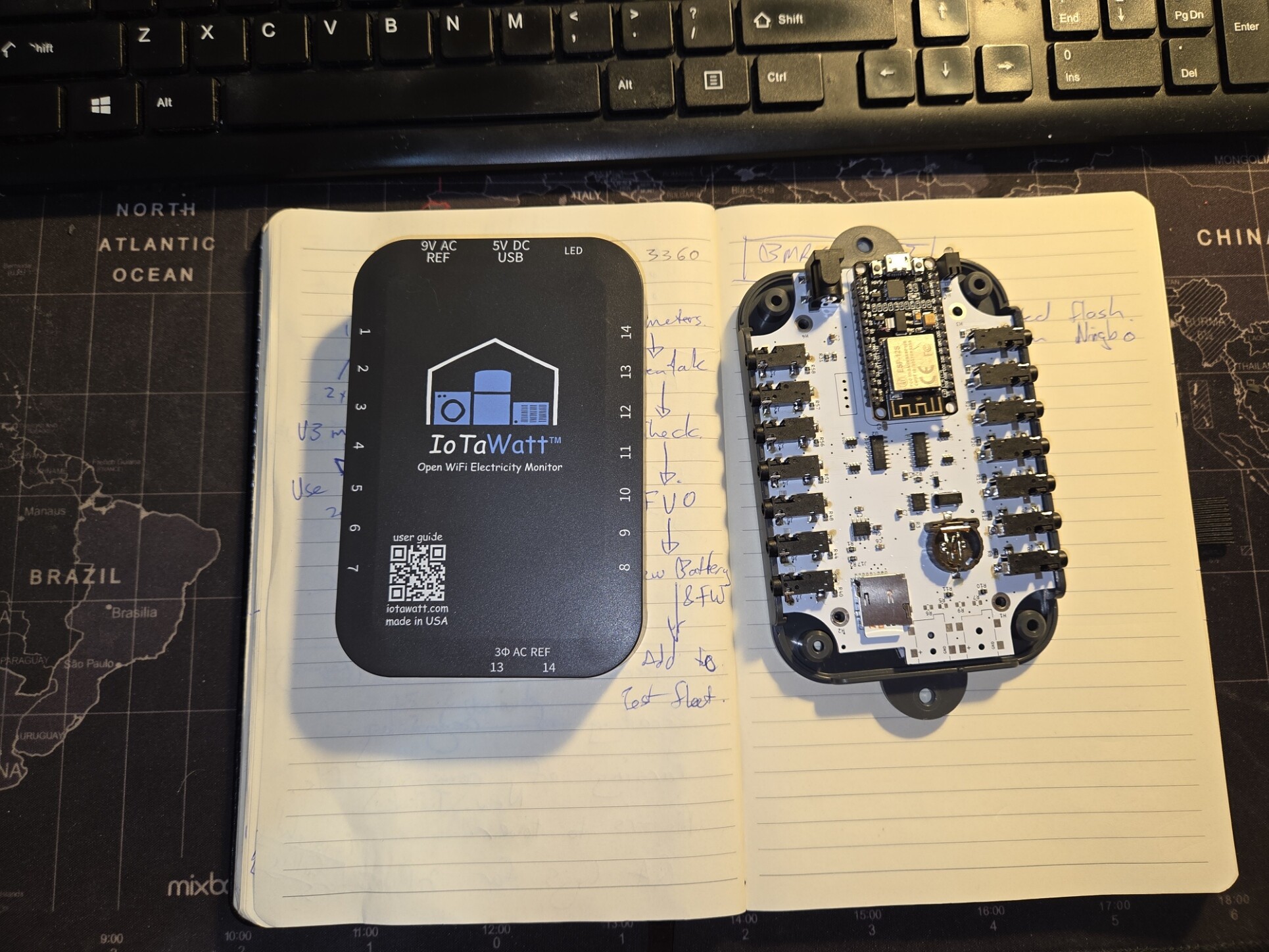

Project Complete.
I have 3x units available.
Note:These are Homebrew PCBs based off of @overeasy’s v5.1 design… the only change being a push-push SD card holder.
These are all in OG IotaWatt v5.1 Enclosures (thanks @overeasy !!).
Willing to ship anywhere in Aus (tracked Auspost parcel) @ AUD 105/unit. Each unit will be shipped with an SD card fitted, and CR1220 battery (not fitted).
All units are able to connect to Wifi and I can confirm that 1 unit from this batch is running perfectly with 12 CTs in my home.
Interested parties welcom to DM or email (address more or less visible on blue PCB in earlier posts) me.
