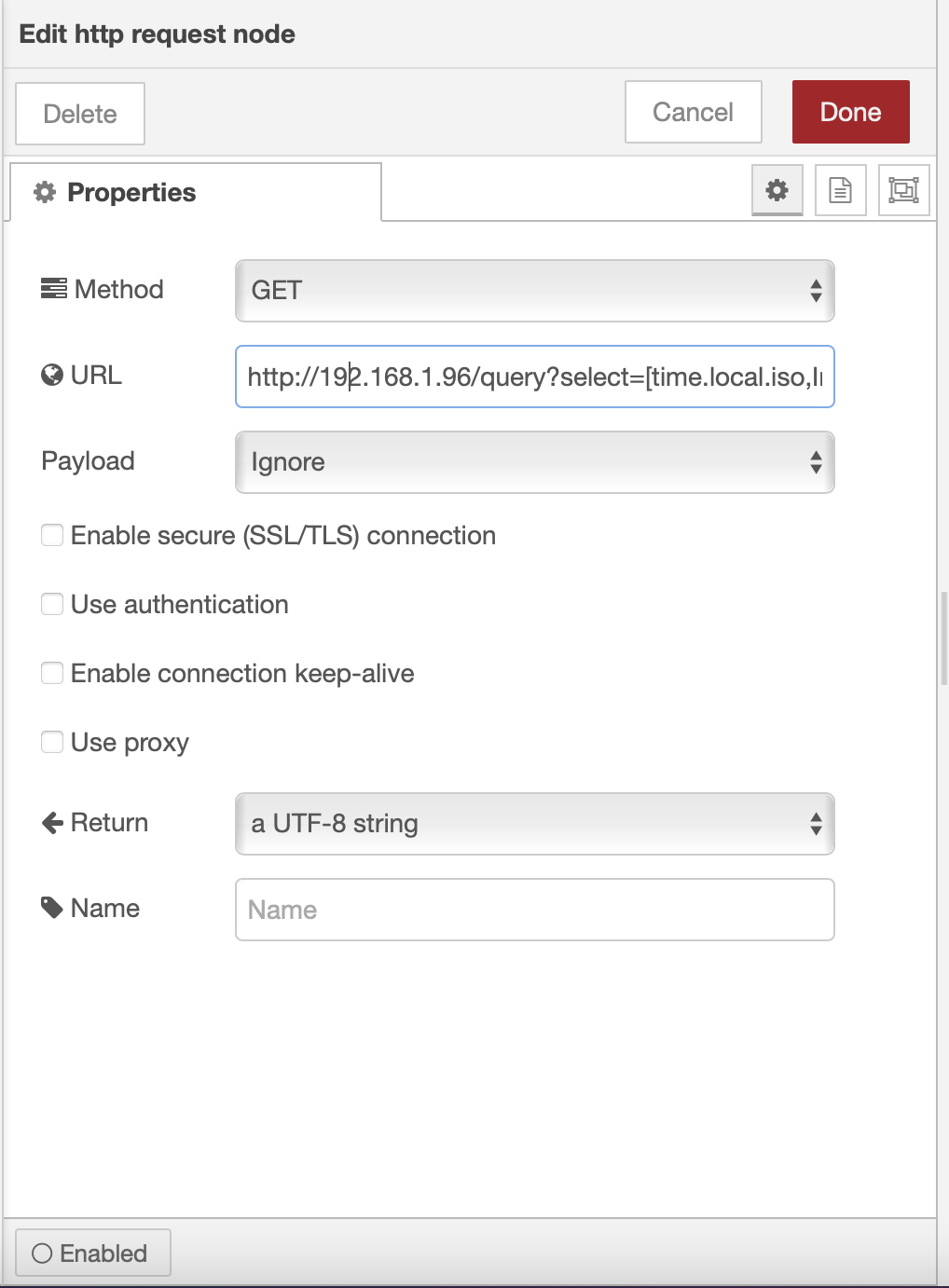

However, if I copy-paste that exact command into a node-red http request node, I get the HPE_INVALID_CONSTANT error reported as per this screen shot, which then says that ‘HTTP /’ was expected. any hints as to what I may be doing wrong?

So I think you need to back-up to the http request node and get some details about the HPE_INVALID_CONSTANT. Can you show the node settings and any diagnostic information that it associates with the http request node?

So can you show the screenshot of the http request node and the response as above so I can verify there is nothing else different?
As best I can tell, the only functional difference between these two requests is that the status request is not chunked. So it looks like that’s the root of the problem.

I did try JSON response [edit] and it too resulted in the same error as the utf8 string. I also tried empty [] brackets (which yielded an error about an array). I tried many other items too such as no parameters at all, escaping or double-quoting ampersands too.
Specifically for the combo you’ve asked for, here’s the options. Do I need to use digest authentication by any chance?
