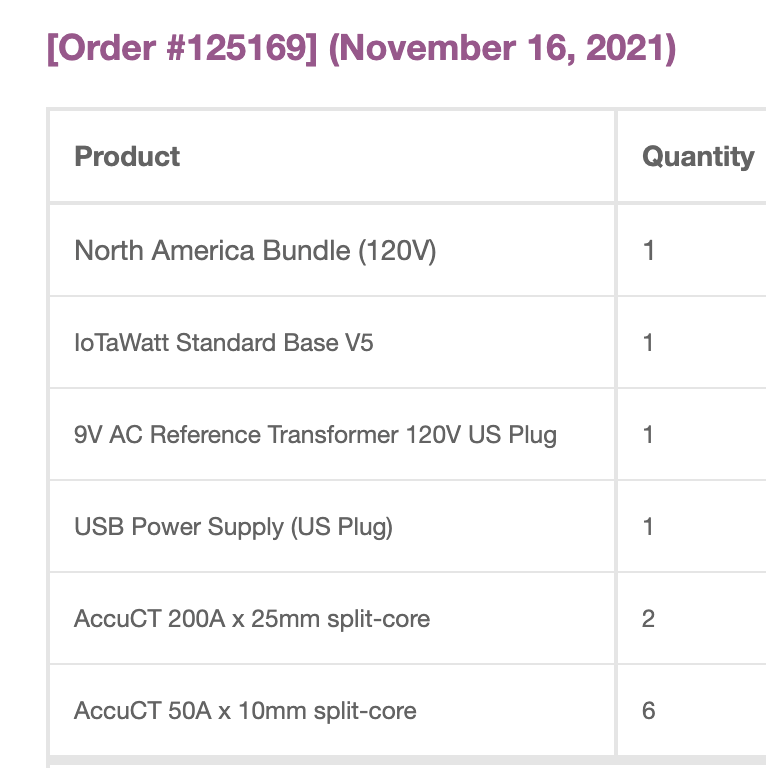

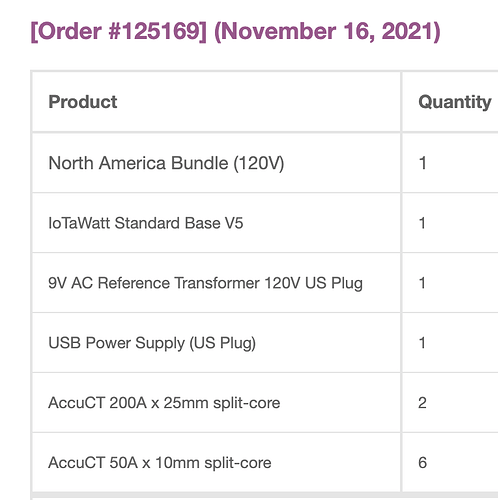

I bought it in November 2021

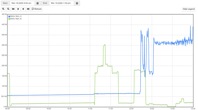

I have two IoTaWatt systems, one for each electrical panel. Neither of these typically have any issues as described in this thread. However, my entire Ubiquiti UniFi network is connected to a pair of UPS’s. Thus, the power would need to be out for an extended period of time before the IoTaWatt systems would have a chance to finish powering up before the WiFi access points were available.
Also, not wanting to distract and TL;DR, but I had a full house outage (major transformer in sub station take out +15K households) last week. I happened to be working at home so used the opportunity to pop my panel cover (after flipping off the mains) and cleaned up some wiring. Utility restored power to my area of town, but my mains were still off. Since no one was home, I decided to do a controlled “power on” to see how much surge I my have when flipping over to generator.
So I turned off all branch circuits and turned on the mains. First branch circuit I turned on was the IotaWatt circuit (Vref and 5V). I waited a minute or so before turning on my second circuit which has what I call my BDF board that is about half of my network (various provider equipment/router/firewall/network controller which does DHCP/switch/WiFi bridge to rental house across street) and my office PC. So the IotaWatt did NOT have WiFi access yet as the AP it connects to is run via my rack equipment in a different part of the basement.
After a few more minutes I turned on my rack circuit which powers my servers and the AP the IotaWatt connects to. Since it had been too long, the IotaWatt had already entered AP mode. I of course couldn’t connect to it via my configured DNS hostname or IP so I power cycled the IotaWatt. All was happy with that IotaWatt (forgot to mention I have two IotaWatts… :smile:
I couldn’t connect to my second IotaWatt in the house across the street as it powered up when the utility power was restored and had no network path back to the DHCP server. It looked like it also came up before the PoE switch and AP came up. Here is the part of its log starting with utility power being restored to house.
