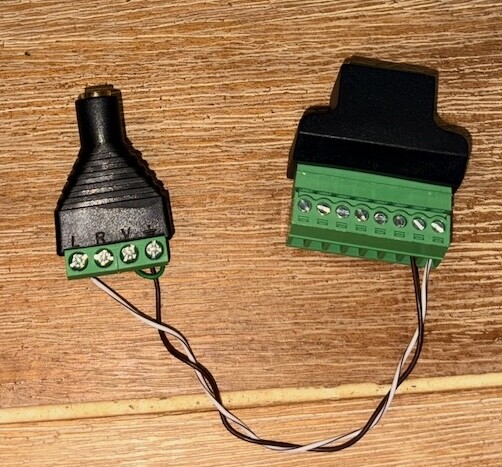

As I eagerly await delivery of my new iotawatt, I want to make sure that I have the wiring correct as I understand it…
I am extending 2 CTs using CAT6 cable and connecting each end to the same 3.5mm markings. Here is what I have (male end at iotawatt and female at the CTs).

I bought these in TRRS because it was cheaper as a multi-pack, and… I had some issues with the ground pin. On the iotawatt it was the labeled ground, on my CT clamps it was V (which might be microphone? it’s not clear from the PIN out).
So I made some small wire bridges (green wire in the photo) to save me needing to remember which was which :sweat_smile:
This is working very well even on long cable runs. The cat6 I’m using is probably 60+ metres, I did a quick test using a loopback on the end to double the cable length and the signal was still strong enough for the iotawatt to read :+1:
