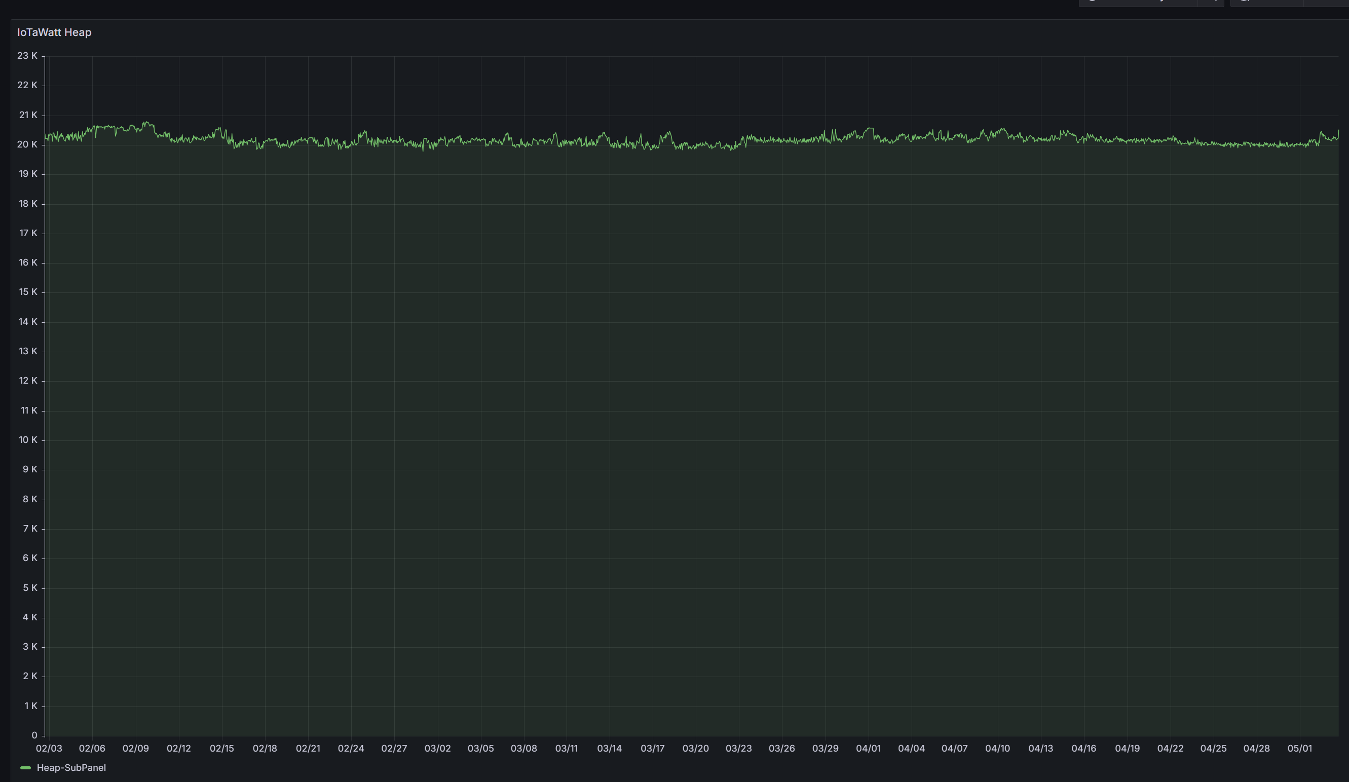

Here is what my busier IoTaWatt heap looks like over the past 90 days. As you can see, its heap is pretty stable. I do not have it connected to home assistant. I do have it uploading data to InfluxDB. I am also periodically (every 30s) querying it from my Hubitat Elevation home automation hub.
