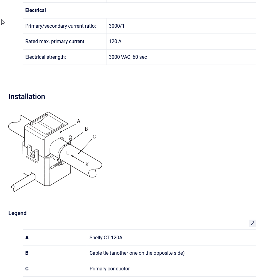

I am not sure which Shelly CT’s you have but they have some on their knowledge base and it has the appropriate information there: CT 120A
mentioned it in my post: 50A ; the 3000:1 does this correlate to the number of turns?
Sorry, I didn’t catch that those were the ones you were trying to use. Yes 3000 is the number of turns.
