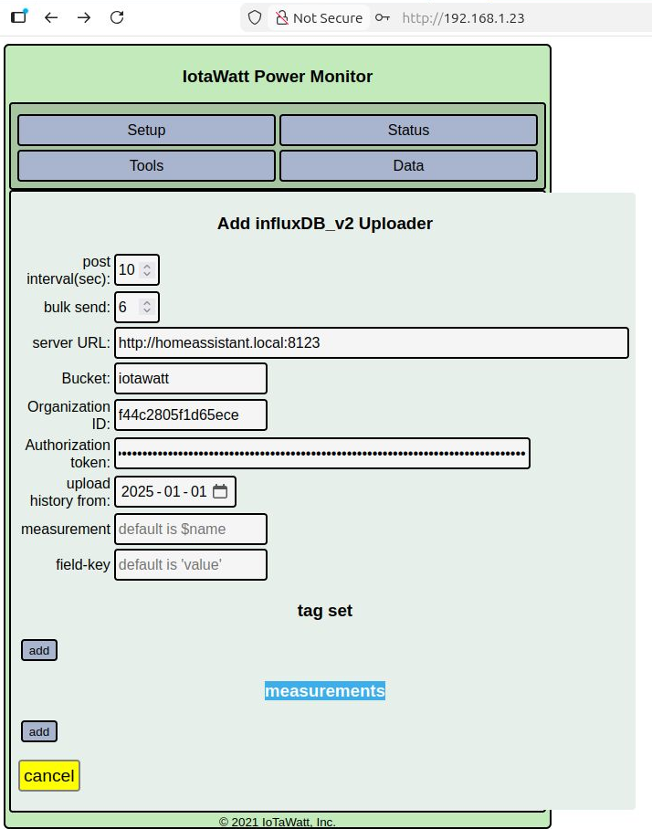

I’ve been trying to get Influx DB v2 working with home assistant. The issue I have is that I enter in all of the information, but there’s no save button with which I can save what I have entered. From my research, the lack of a save button is supposed to mean some of the information I’ve entered is missing or inaccurate, but I can’t figure out what that would be.

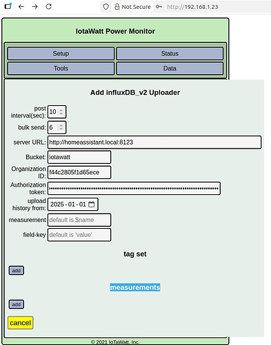

Attached is a screenshot of what I have tried entering. I’ve tried entering $name and value in the measurement and field-key fields, as well as just leaving them blank which I understand should work. But neither configuration gets me that save button.
Any help would be much appreciated.
Offhand you need to specify at least one measurement. That will probably activate the save button.

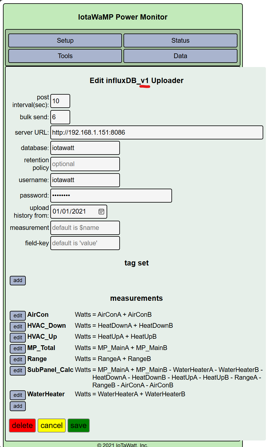

@swaff - Here is what my ioTaWatt InfluxDB configuration looks like. Please note that I use InfluxDB v1, not v2, with the HA InfluxDB add-on.

Yes, the issue was the lack of any measurement. Once I added one, the save button appeared.
