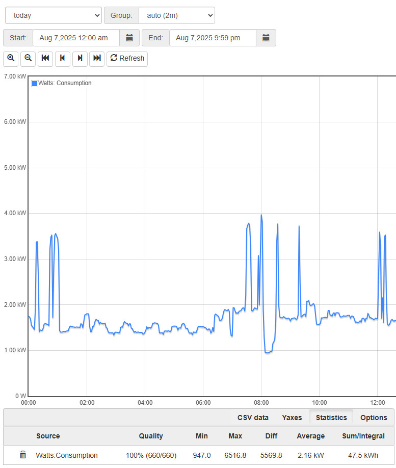

Im considering getting a solar battery and was going over some of my data.
Upon reviewing, it seems data in influx is not macthing that of iotawatt and want to ask if my flux query is correct??
Flux query:
from(bucket: “iotawatt”)
|> range(start: today())
|> filter(fn: (r) => r._measurement == “consumption” and r._field == “watts”)
|> aggregateWindow(every: 10s, fn: mean, createEmpty: false)
|> integral(unit: 1s)
|> map(fn: (r) => ({ r with _value: r._value / 3600000.0 }))
|> sum(column: “_value”)
This returns 30.10, whilst graph+ has 47.4
What am i missing?
Cheers
