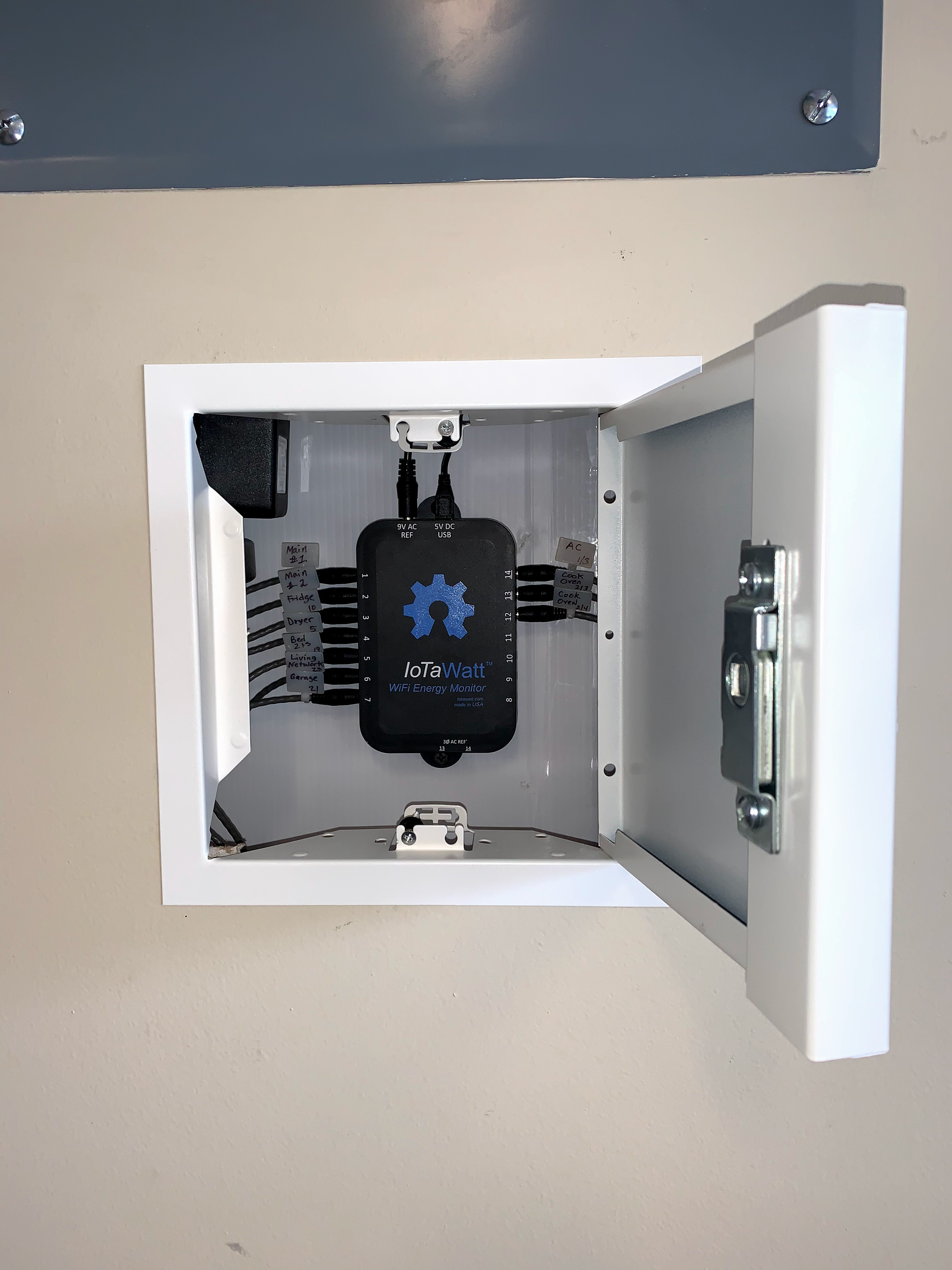

Thanks to Bob and @frogmore for the help and suggestions in getting my setup complete. I ordered the NA bundle along with a few extra CTs and here is what it all looks like with some before and after photos:
My panel in the garage:
Cover off:
I decided to put the IoTaWatt in the wall under the main panel. Added a breaker and attached receptacle to the inside of the stud:
Attached the CTs:
Hook everything up to the IoTaWatt:
Clean it up:
Install complete:

Really nice and neat installation! I love the recessed box. Thanks for sharing.

This is a great looking install!

Can you tell us the make and model of that enclosure? I’m trying to figure out how your duplex receptacle is accessible inside the enclosure… did you cut the side off?
This one: https://www.amazon.com/gp/product/B076VBTW7L/ref=ppx_yo_dt_b_search_asin_title?ie=UTF8&psc=1
