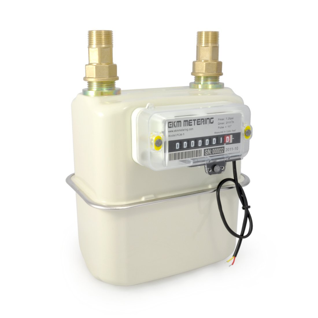

Can the IOWatt data system handle gas meter data?
I’m thinking of using the gas meter from EKM, here’s the link
Tx
Ray
IoTaWatt doesn’t do pulse outputs. It’s strictly an electricity meter. The only way to combine the data is to upload both to a database. You might investigate using Home Assistant Energy, or a database like influxDB or Emoncms, all of which work with IoTaWatt.
