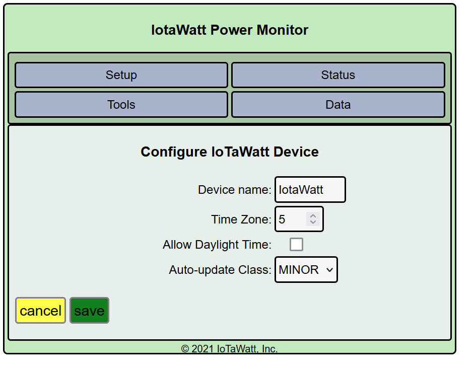

BTW/ it appears you have split-phase mains which implies you are North America. Your IoTaWatt time zone is set to +5 but for instance US Eastern Time is -5. You might want to check and correct if necessary.
Thanx for catching that. I corrected it to -5. That’s not something I’d normally miss, lol. Thank you. In the mean time I put an SSID on the closest AP just for the iotawatt. I’ll see how it goes and report any success or failures. Thanx!
