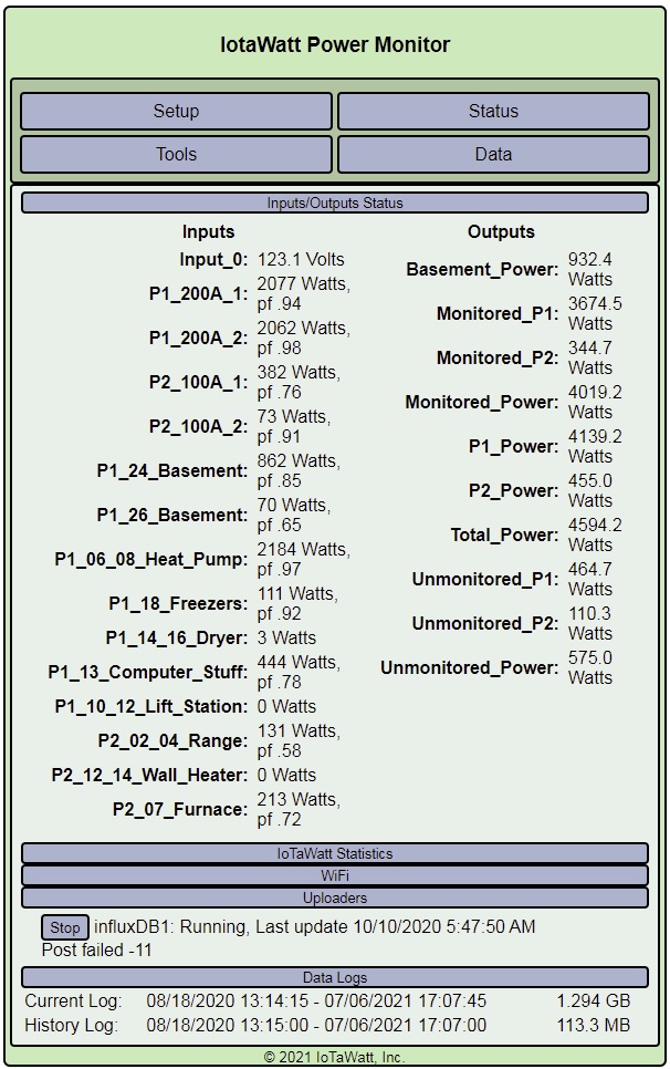

Here’s a screen shot right after the notebook shut down. A few seconds after this was taken the Post Failed changed to -4 but the Last Update time remained the same. I’ll leave the notebook off for an hour or so before I restart it.
Turned the laptop back on and took the following screenshots:
- IotaWatt right before restarting laptop.
- IotaWatt right after restarting laptop with with InfluxDB stopped. You can see it jumped from 5:47AM to 1:20PM.
- Picture of the Grafana output with the straight lines being the time the laptop was stopped.
- Picture of the InfluxDB database dump. You can see right in the middle of the screen where it jumps from time stamp 09:47 to 16:28.

In the episode described above the PC is described as “shut-down” then “restarting”. In the initial problem description, the problem was described as being caused by “hibernating” and presumably subsequent awakening from hibernation. “Shut-down” and “sleep” are specific terms in Windows 10. While I recall hibernate being a term used in prior Windows versions, I don’t see it in Windows 10. I do think that there would be a significant difference in how influxDB works in sleep vs shut-down and essentially a restart.
The screenshot was taken at 17:07:45 on July 6. IoTaWatt had been uploading history and was at 10/10/2020 at 5:47:50 am (9:47UTC). -11 return code is a timeout, and the subsequent -4 is unable to connect.
The message log shows that the IoTaWatt was running at 17:07. As we know it thereafter experienced errors (-11 then -4) until influx restarted and the subsequent stop at 13:20:20 is logged.
The mystery here is how the time advanced without successful upload of the data. The influx data shows a gap between 5:47:50 (UTC-4) and 12:28:00. There has to be some kind of creep happening. I’ve looked at the error recovery code but will need to try to recreate to track it down.
This reinforces the idea that the posting time is advancing during error retry.
