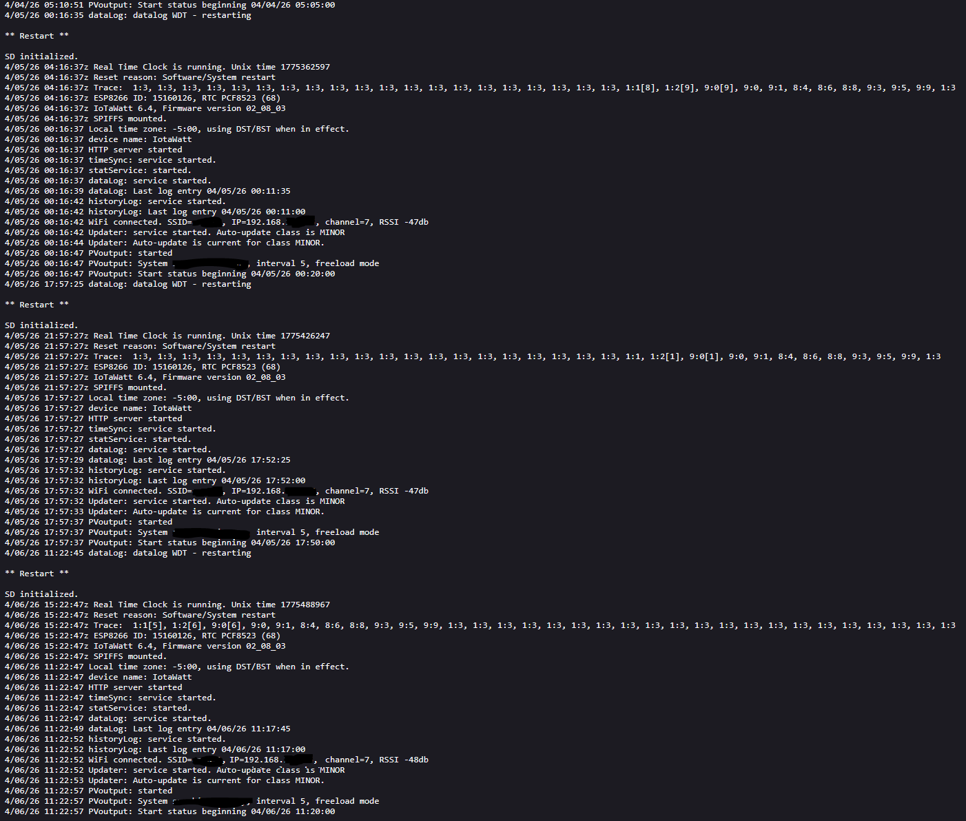

Hi, just happened to notice that my unit is rebooting everyday and trying to figure out why? Here is the log from the last couple days.
Datalog Watch Dog Timer (WDT) exception is very rare. The datalog WDT will trigger if the datalog is not updated after 5 minutes. There is not much information available to diagnose what is causing this, but I can offer some possibilities:
The trace indicates that the web-server was active at the time of the WDT expiration. Because of the single -thread operation of the ESP8266, the web server monopolizes the CPU when handling a transaction. For the most part, transactions are handled relatively quickly and have little or no impact on sampling and data recording. However, there are some requests that can take extra time to handle. In particular, queries can take a long time as they can require reading a lot of data from the SDcard. For that reason, queries length is limited by default but there is an overide LIMIT parameter that will allow longer queries. If you are using query explicitly you might check the response times for those queries (the browser debugger will time transactions). Even if not doing explicit queries, the home assistant integration uses query to gather IoTaWatt data. There could be some issue with that. A simple test would be to disable the integration for a day or so and see if the problem is mitigated.
I wouldn’t rule out datalog corruption or SDcard issues but there is no direct historical link to those types of problems and datalog WDT restarts, so HA involvement would be my first choice.

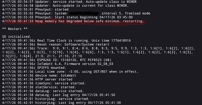

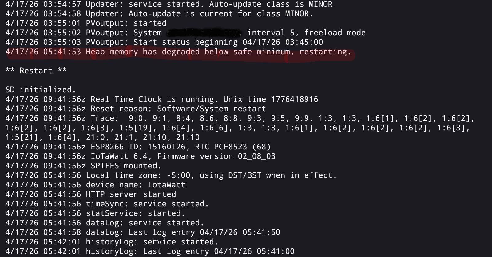

So I checked the log this morning (HA integration still disabled) and the highlighted message came up (heap memory has degraded below safe minimum, restarting. RSSI was -45db).
Does that help narrow anything down?
Well it reinforces the WiFi suspicion. Heap memory degradation is almost always associated with WiFi issues. I don’t believe there are any memory leaks in the IoTaWatt firmware, so my assumption is that there is one in the IP stack, probably the LWIP code supplied with the ESP8266/Arduino IDE, and it seems associated with exception handling.
It usually happens with poor RSSI, but there have been some cases reported where the RSSI very good like yours. Maybe too good. In any event, have you tried the disconnect experiment the I suggested above?

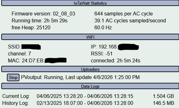

I might play around with my wireless. Is WPA3 supported?
Not sure with the current version, but it is probably more about using channel 7 which is an overl;apping channel. The favored are 1, 6 and 11. Also, the RSSI is VERY strong. Maybe putting some distance between the AP and the IoTaWatt would help or reducing the AP signal strength if you have control over that.
The router is set to auto channel based on interference (has been since I got the IoTaWatt). I’ll run a scan when I have some time and set that SSID for one of the less busier channels (1,6,11).
Unfortunately it isn’t possible to move the AP or the IoTaWatt :frowning: .
As I understand it, it’s not so much about being busy as the favored channels do not overlap their bandwidth with other channels:
The 2.4 GHz WiFi band operates between 2.400 GHz and 2.500 GHz, divided into 14 channels (1-14) that are 20 MHz or 22 MHz wide. Channels are spaced 5 MHz apart, with center frequencies ranging from 2.412 GHz to 2.484 GHz. To minimize interference, it is recommended to use non-overlapping channels 1, 6, or 11.

I changed the AP settings to channel 1, lowered the transmit power (to lowest setting) and also changed the channel width to 20MHz. Will see how it goes the next few days. The RSSI went up slightly from ~-48db to -53db (at lowest transmit power).
