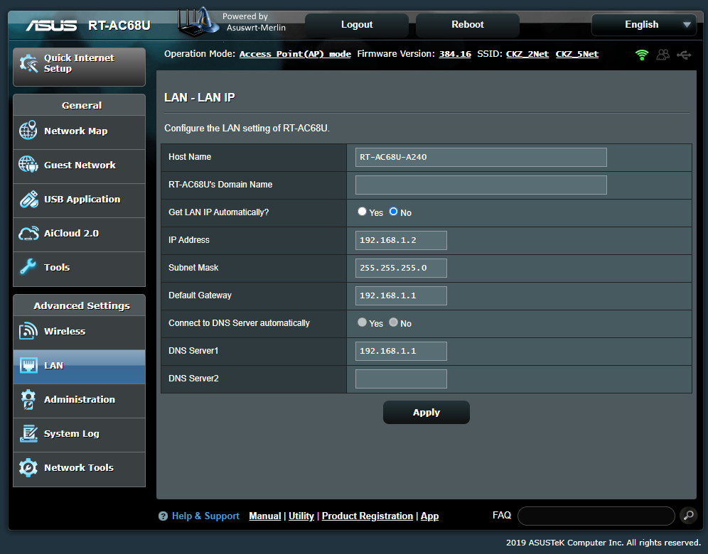

Main router :192.168.1.1
AP1 192.168.1.2
AP2 192.168.1.3
Garage: 192.168.1.4 same LAN with different SSID name/channel

Nope… for AP routers, no subnet, no DHCP client list. My network is pretty simple and I am not sure what more info I can provide. Below are a few screenshots of 3 of the routers. Sorry for all the post. Would not allow me to post more than 3 pics in one post

This is not a mesh setup - this is a multi access point wireless network
I used to run exactly this with these same units until recently when i replaced them with TP-Mesh (Proper Mesh) units.
By putting these devices into AP mode you essentially treat them as a bridge between the Wireless network and the Wired network so they provide no DHCP or other features.
