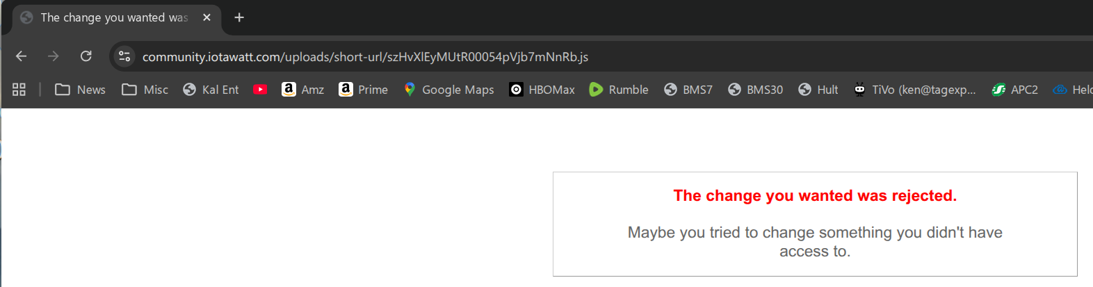

When I click on the graph2.js to download I get and can’t seem to get it.
Don’t know what’s going on with discourse. I get the same thing. I’ve modified the post to take you to github where there is a download button for the file. Probably better than putting a static copy in the forum anyway.
