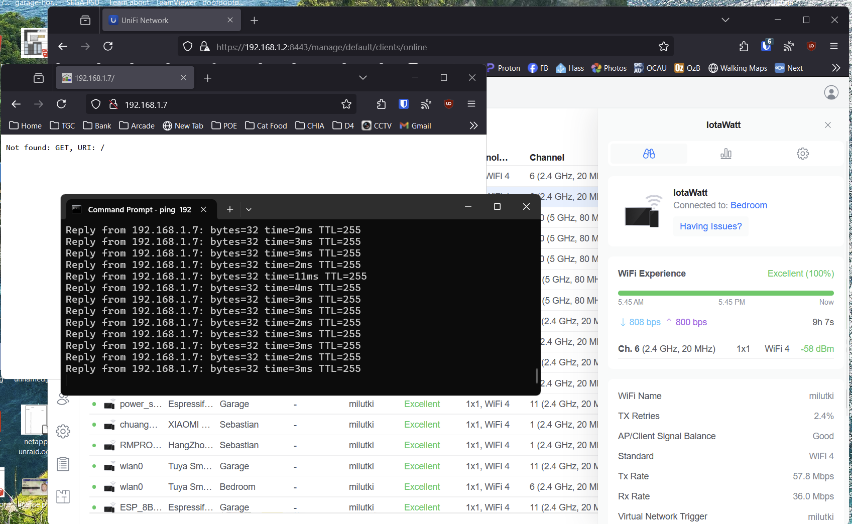

Recently my iottawatt has started going offline, can be as frequently as once per day
When this happens, the gui is unreachable, but i can still ping the device on my network. Power cycling it fixes it everytime
