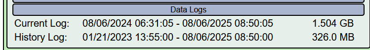

Here’s an example of my own system as @overeasy explains…
Got/installed mine in Jan 2023… and has been running since then. You can see the Current Log has a year’s worth at 1.504GB up to today. The History Log is only 326MB after 2+ years so it hasn’t started overwriting yet.
