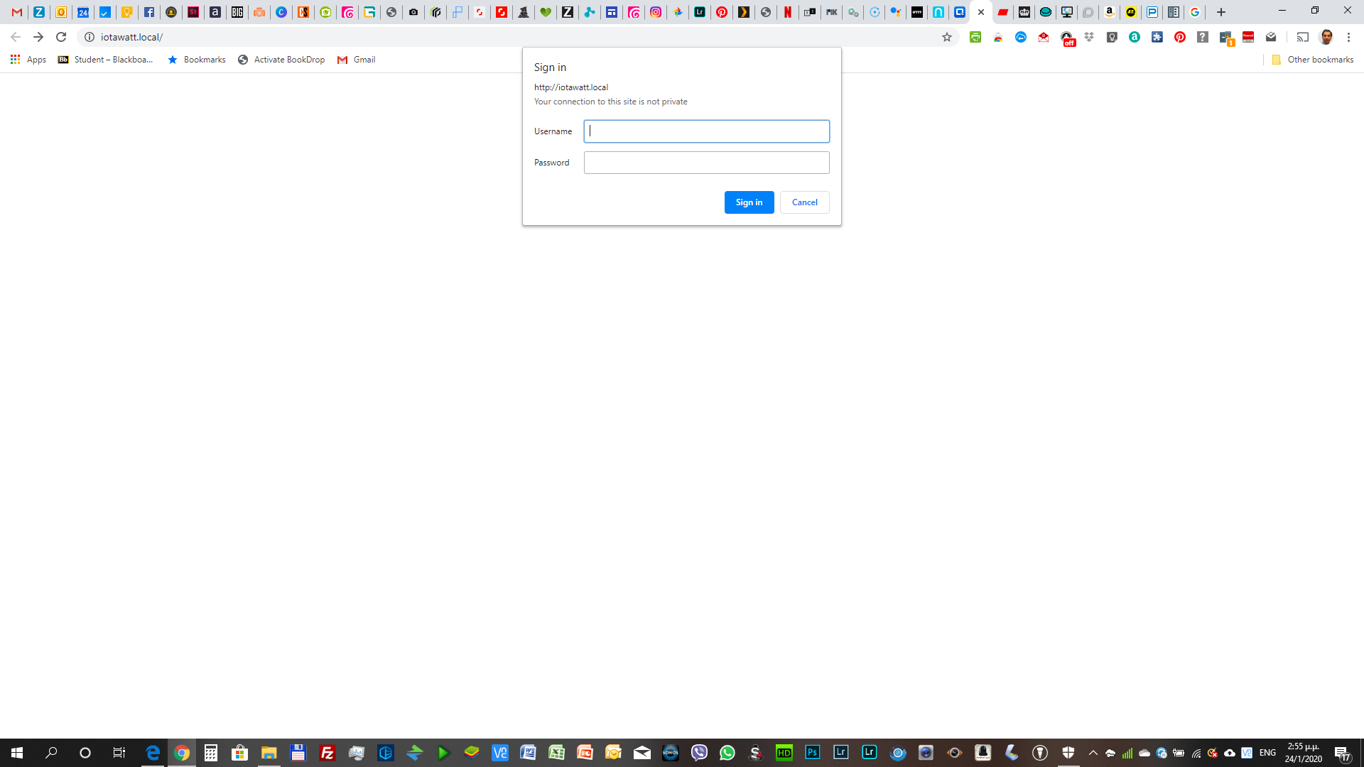

I was able to get my IotaWatt up and running normally, connected to it and set it up. However, as of yesterday, whilst the LED is steady green, when I try to connect to it either via my PC Chrome browser, Microsoft Edge browser or via my Android device Chrome browser after I type the http://iotawatt.local/ URL or IotaWatt’s IP address, it opens up a Sign-in screen requesting a Username and Password and stating the message: “Your connection to this site is not private”. I have never set up any username and password to access my IotaWatt. Can anyone help, please?
Thanks for coming back to me. I have attempted to upload a screen-shot of the sign-in screen.

OK, I’m pretty sure a password has been set. I understand that you deny setting one, there could be other explanations, nevertheless, the password must be removed.
First, do you know what auto-update class is set in your device. MAJOR would have updated a couple of days ago, and I want to rule out that had anything todo with it.
Next, the only way to reset the password is to remove the SDcard and delete the password file using another computers. Is that something you want to do, or alternatively, you can send it to me and I can do it.
If you want to proceed with card removal, I can provide instructions for removal and which file to delete.
