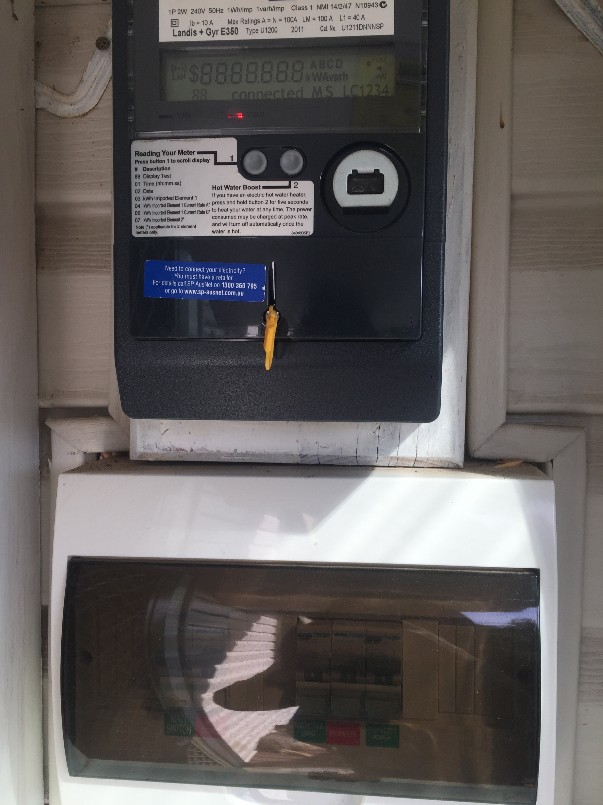

I’m having a solar system installed at my house in the suburbs of Melbourne, 5kw Inverter, Goodwe MS GW5000-MS, 6.6Kw panels, in 3 string config.
I just looking to confirm what I need for my Aussie bundle order. I’m assuming the following based on my switch board, so I can monitor all circuits.
1 x IoTaWatt Standard Base V5
1 x AccuCT 100A x 16mm split-core
5 x AccuCT 50A x 10mm split-core (circuits: inverter, aircon, protected light, power, protected power)
And locally I will need to acquire a USB power supply and something like this for the VT: https://www.jaycar.com.au/9vac-1a-unregulated-power-supply-7dc-plugs/p/MP3027
Can someone confirm is this is correct or if I should consider something else?
