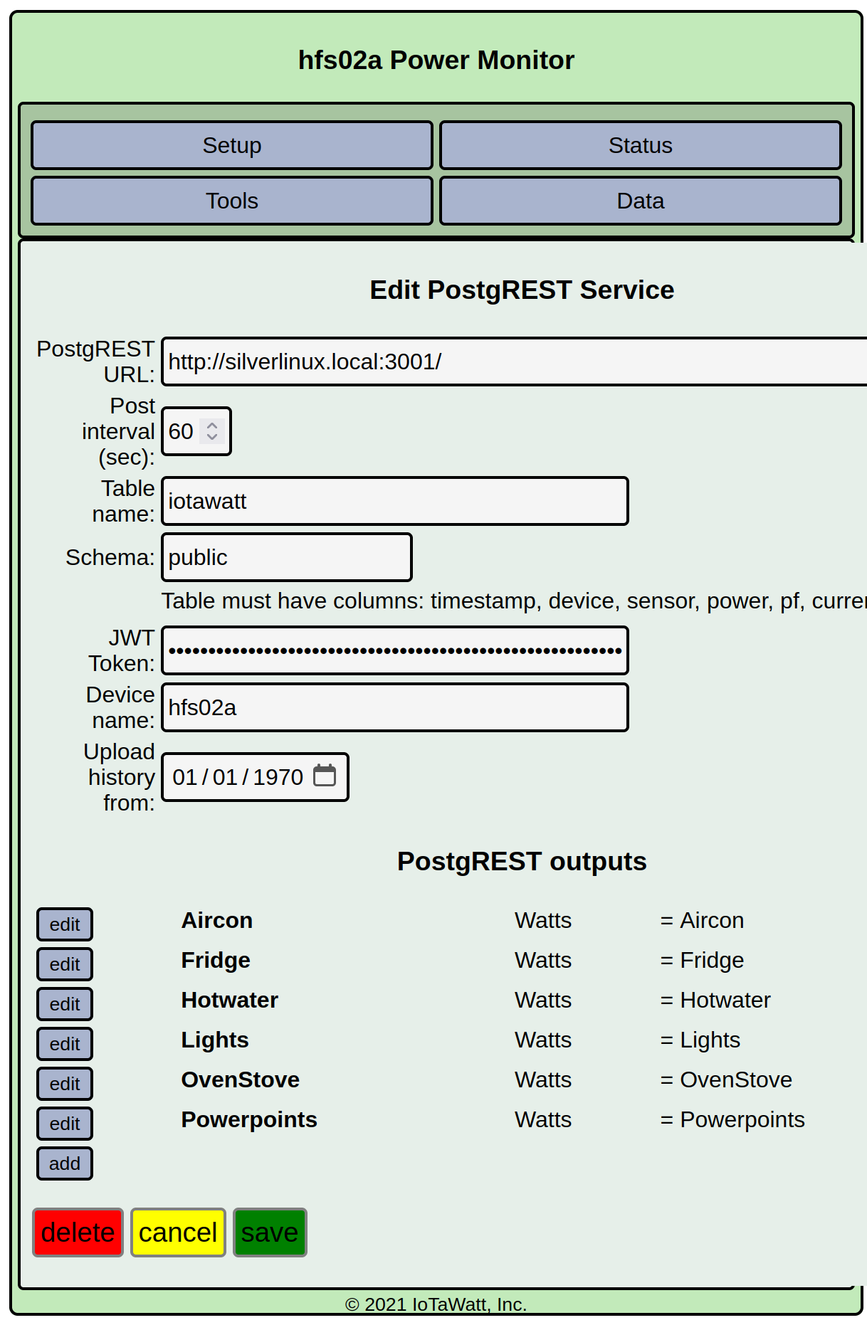

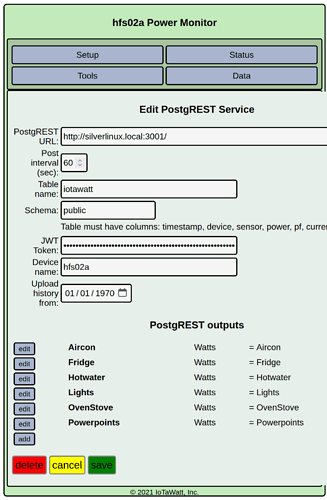

Some snaps are below…new uploader “PostgREST”…

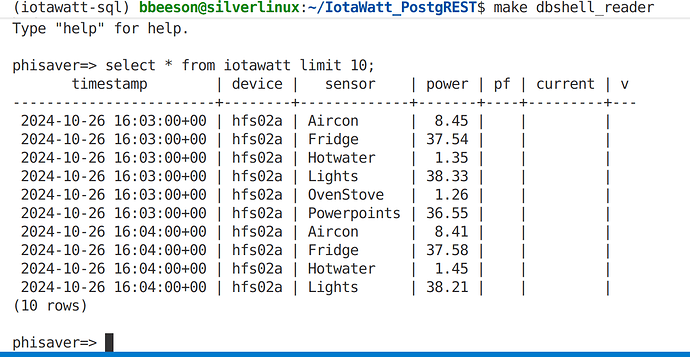

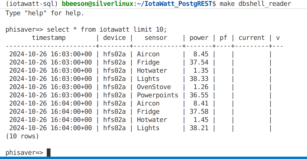

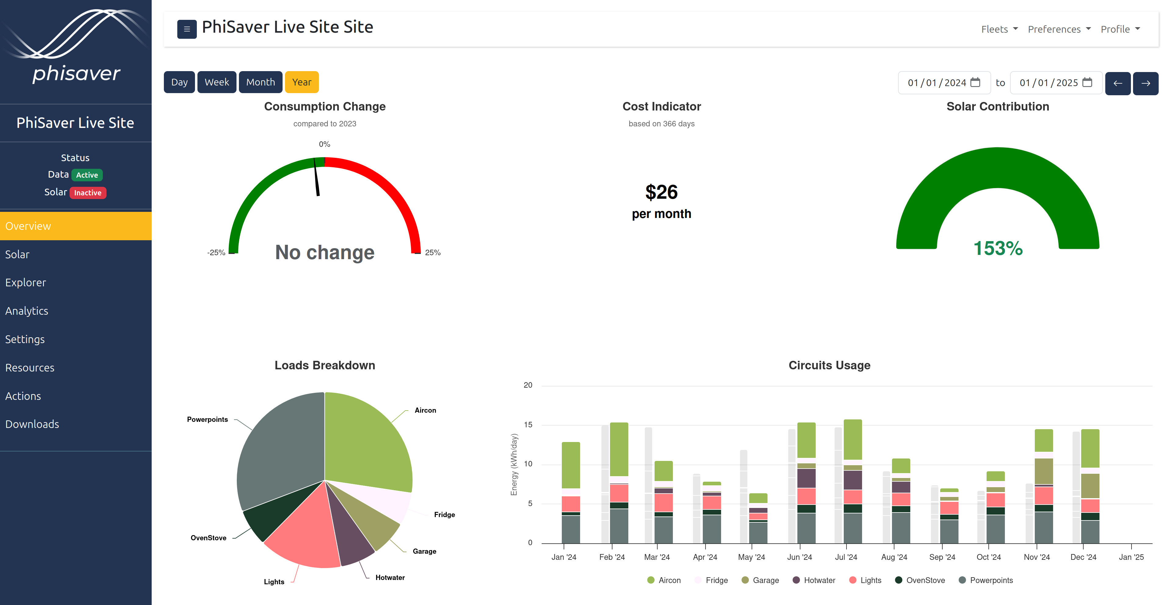

… writes to an SQL database:
… then view the database with PhiSaver or Grafana as normal:

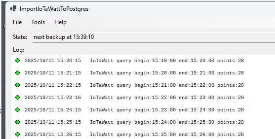

great work - very interesting - I took a different tack a few months ago after abandoning InfluxDB (good decision in hindsight & should have never used it) (your solution is more elegant though requires a firmware update) - I already have a 24/7 server running Windows, so wrote a new C# program which does a query every minute (setting) & insert the data into postgres; your schema requirements wouldn’t have worked for me

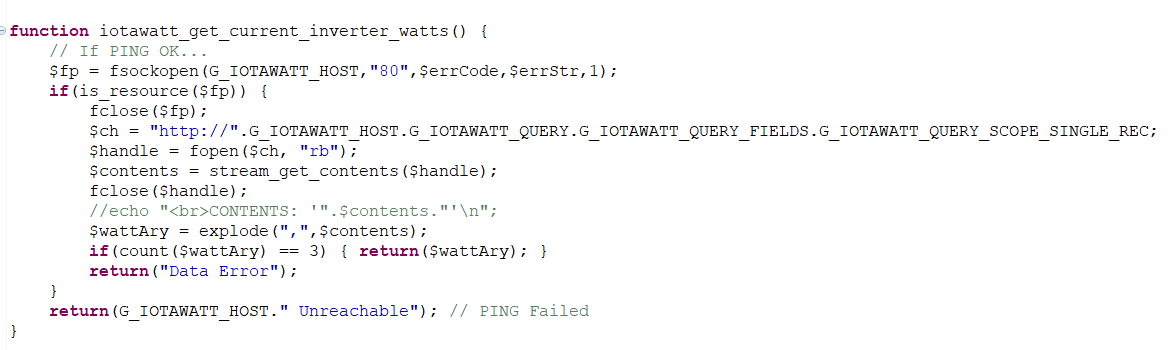

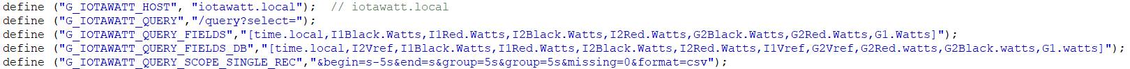

In my case, I wrote a couple of PHP functions using the IotaWatt Query API to pull data. I really like how accessible IotaWatt data is. To give an idea, here’s the PHP function I use to pull ‘current status’ for my web page dashboard.
