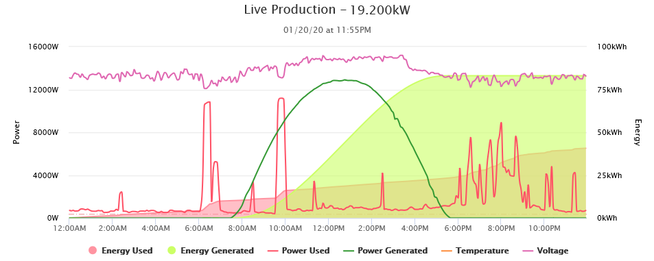

Got an IoTaWatt a few weeks ago and am super impressed with the hardware, software, and community behind it. For my install, I added a 2" conduit in the bottom right of my breaker box to poke through the other side of the wall which is in a closet. I added an Orbit sprinkler box with the cheap GFCI outlet swapped for a normal decorator duplex outlet. Makes for quite the tidy install.
I purchased enough CTs to use all the channels. Currently monitoring both mains, solar backfeed (top left breaker), a subpanel to a shop (top right breaker), and various high-use applicances and rooms. I see several people using one CT to monitor solar - however I have a neutral on my backfeed and am using two CTs in case the legs are uneven, but I’ve never seen them vary by more than a few watts. Maybe I can repurpose one of those CTs somewhere else.
I plan on using this to monitor overall usage and see where I can shift that usage into the solar generation time since our net metering only pays for exported power at about half the rate of inported power.

Yeah, 19.2kW of solar is probably overkill…but I got a great deal on several new, old stock panels and inverters. I did the install myself which helped get the cost to about $0.85/W before any tax credit. It uses some older SMA string inverters, but honestly I think I prefer those to microinverters since I don’t have any shading issues where the panels are installed.

I suppose our usage is decently high - I calculated needing a 12-14kW array to get us to net zero. With supplies being so cheap, I built as big as I could get approval from the electric company. We’re planning on adding on soon and my wife has thoughts of getting a Tesla cyber truck when they’re released, both of which would increase our usage.
