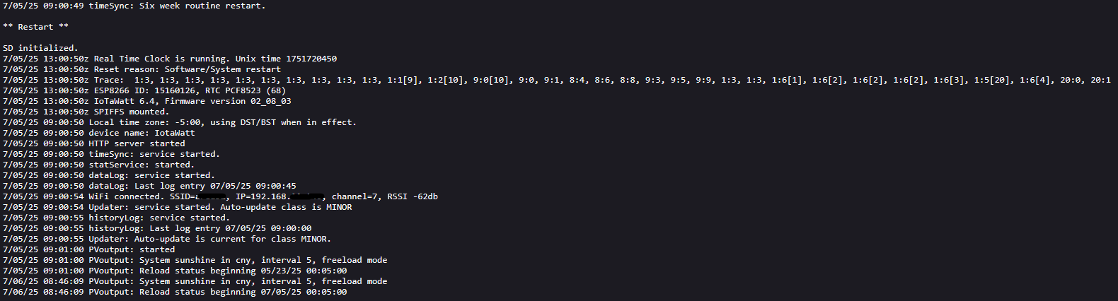

Hi, I happened to get an email that my PVOutput has been idle for X amount of time (not reporting). So I looked at the iotawatt log and see that it did its 6 week restart and showed a reload status beginning 05/23/25.
I then looked at the status → uploaders and I think it was stopped so I went to the setup → data uploaders and changed the date to the date it stopped (before the reboot) then clicked save and it started its upload. There weren’t any “Transaction Rate-Limit exceeded.” messages before I did this so I was wondering why it didn’t automatically load data even at the old date?
