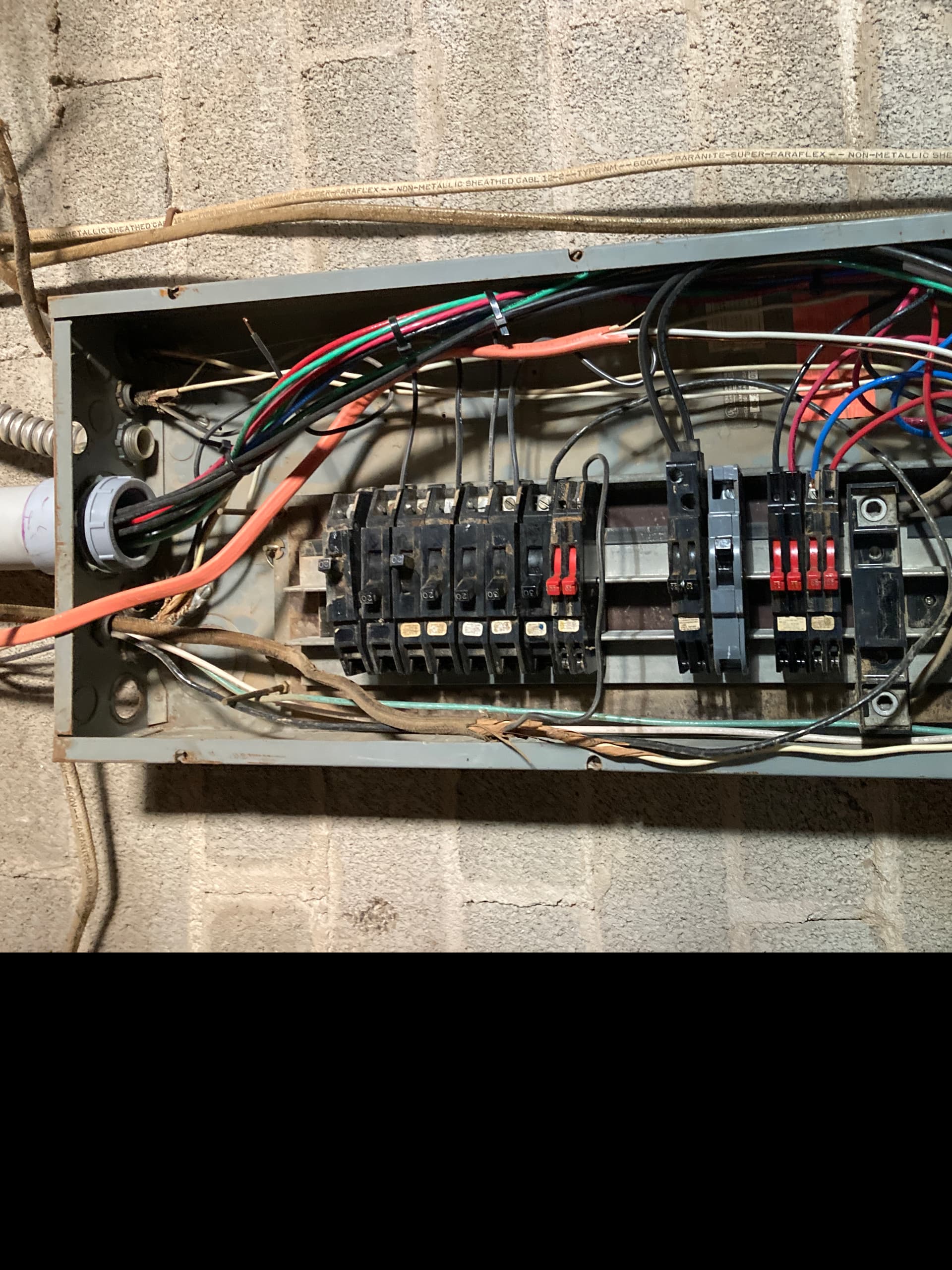

Each 240V breaker will require two current transformers. You can connect up to 14 current transformers to one IoTaWatt. So the answer is yes you can easily connect them all to one IoTaWatt. Can you post a picture of the breaker box with the cover removed to show the wires inside?
I know it looks scary. LOL. We have had part of it rewired to support the 2- 30AMP plugs and the 1- 50AMP plug, however we are going to get the whole barn rewired (and new panel) as soon as we are done with the big house remodel we are doing. :stuck_out_tongue_winking_eye:

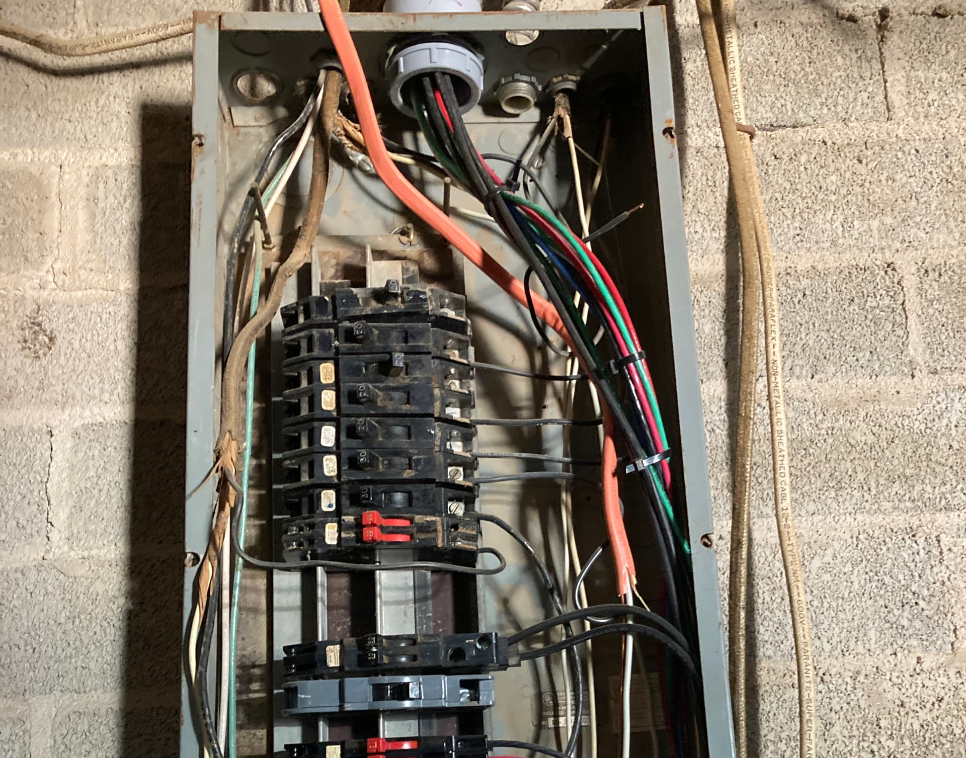

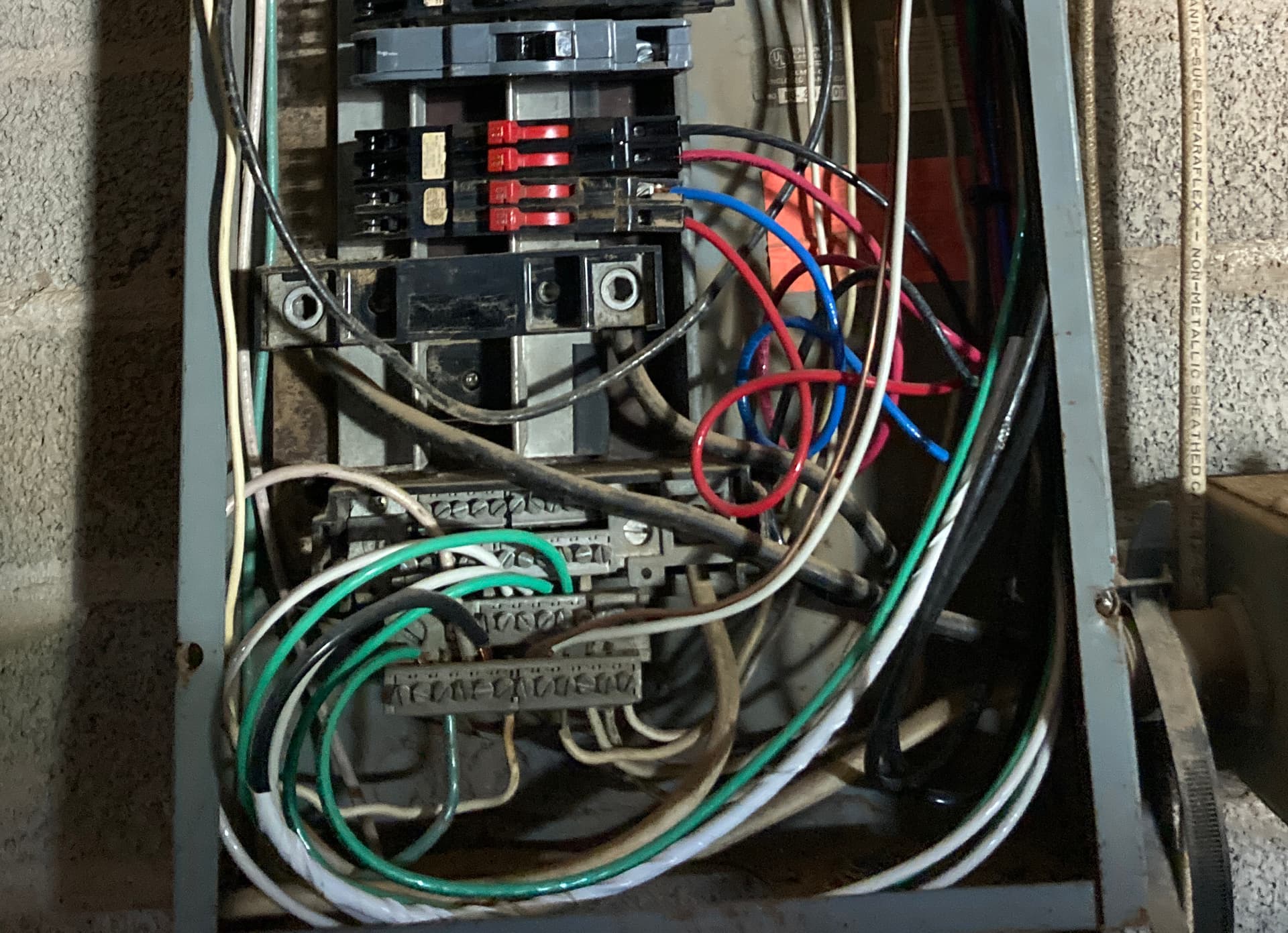

Not sure why it is sideways. Hope you can see it ok.
Your system is also cutting off the bottom half of breaker box. Trying to edit and send another.
Hopefully having 2 images makes it easier to see the whole thing.
That’s good enough. There is room to install the CTs. If you want to monitor anything else in there, you would have excess capacity to do so.
Regarding replacement of the panel, it appears that the ground and neutral are bonded (connected together) which isn’t copacetic in a branch panel. I don’t have the big picture, but if you are connecting to an RV, I’d be careful about standing barefoot in a puddle and grabbing metal on the RV.
