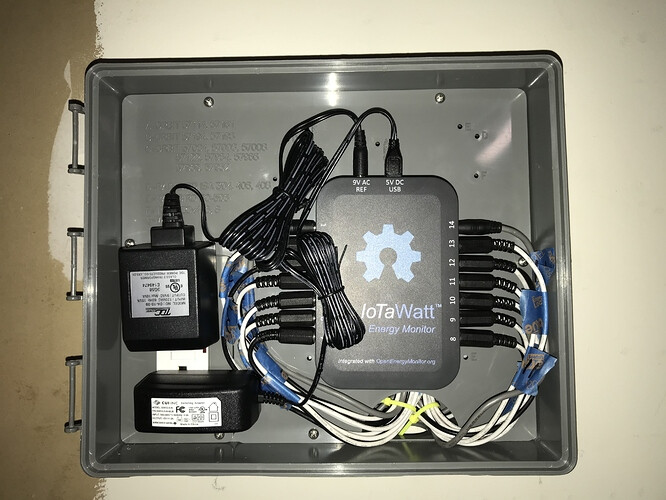

  1. How big is it? Not how big the board is, not where I can download 3d prints. What is the size of enclosure I need to buy that will fit the board, and the CT’s plugged in. What’s it’s total footprint.

Many folks have had success with the orbit sprinkler box.
