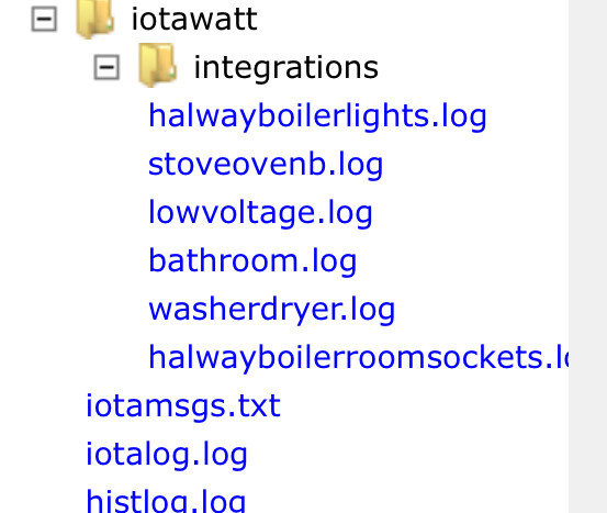

Thanks! And yes, you’re totally right regarding the 16 symbols, not 15
I guess I’ll need to dig deeper.
Perhaps since I self-compiled something changed in platformio and esp-idf.
Log files with long names exists, graphs seem to work
Recommend you review what integrators are, how they work and when you should use them.
