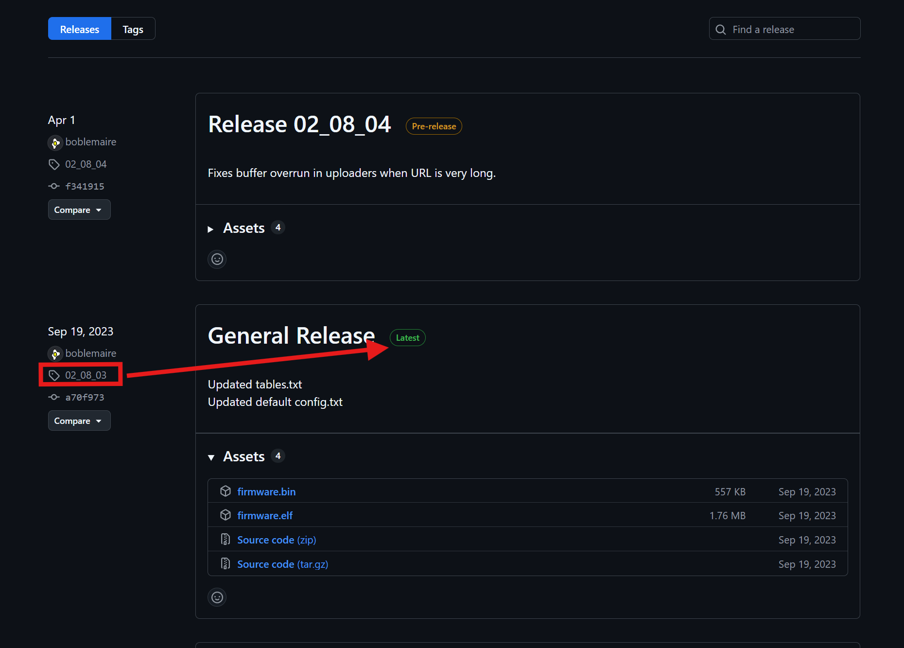

Good afternoon. I haven’t had the need to check in on my system in a long time. While recently doing so I noticed I am on firmware version 02_08_03. While browsing this thread I noticed there were no firmware versions on the linked page.
I understand there has been a change in the distribution of the product and wondering if there are any updates that are available or beneficial and if the auto updater in the firmware is still active.
Thanks.
02_08_03 is the latest General Release available, per Bob’s GitHub repository.
Auto update is active. I hope to put out a new release in January with support for a new uploader and a few minor fixes/improvements. It will first go out to auto update class ALPHA then if no problems BETA. I usually wait a few months of ALPHA/BETA use before sending it out to MINOR and MAJOR classes.
