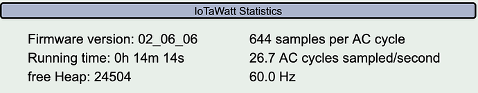

Note: the unit is not currently installed in the panel, which is why all of the CTs are reading zero. I’m just trying to get it working with voltage reporting first, then I will install it.
The LED is green, slowly blinking between bright green and dim green.
Logs:
